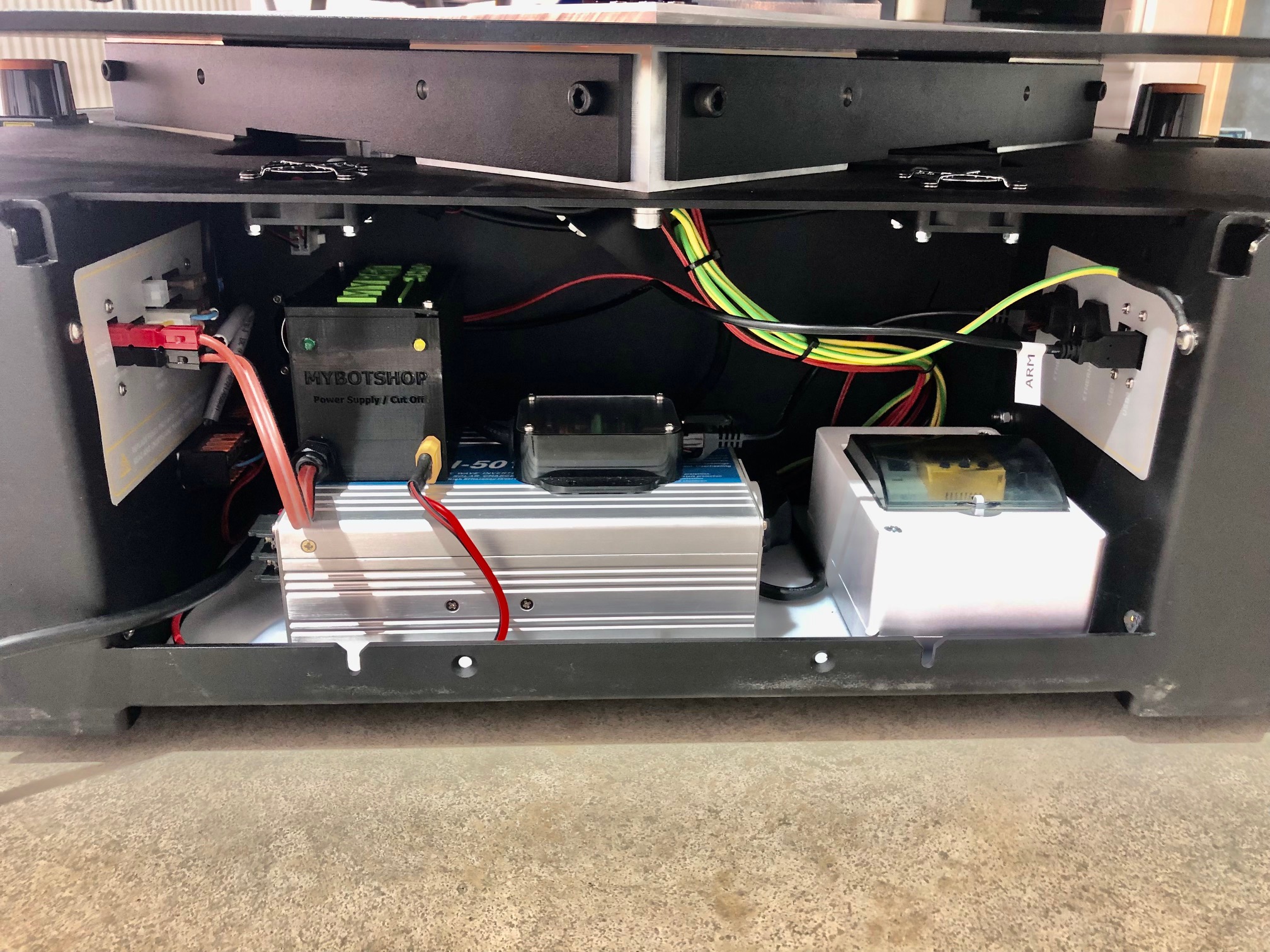

Safety-Controller
DC-AC Converter
The Panda is connected to a DC-AC converter which powers it from the external battery. Specific features of it are:
Conversions of
24V DC
-230V AC
User can supply power to the arm asl well as cut off power to the arm

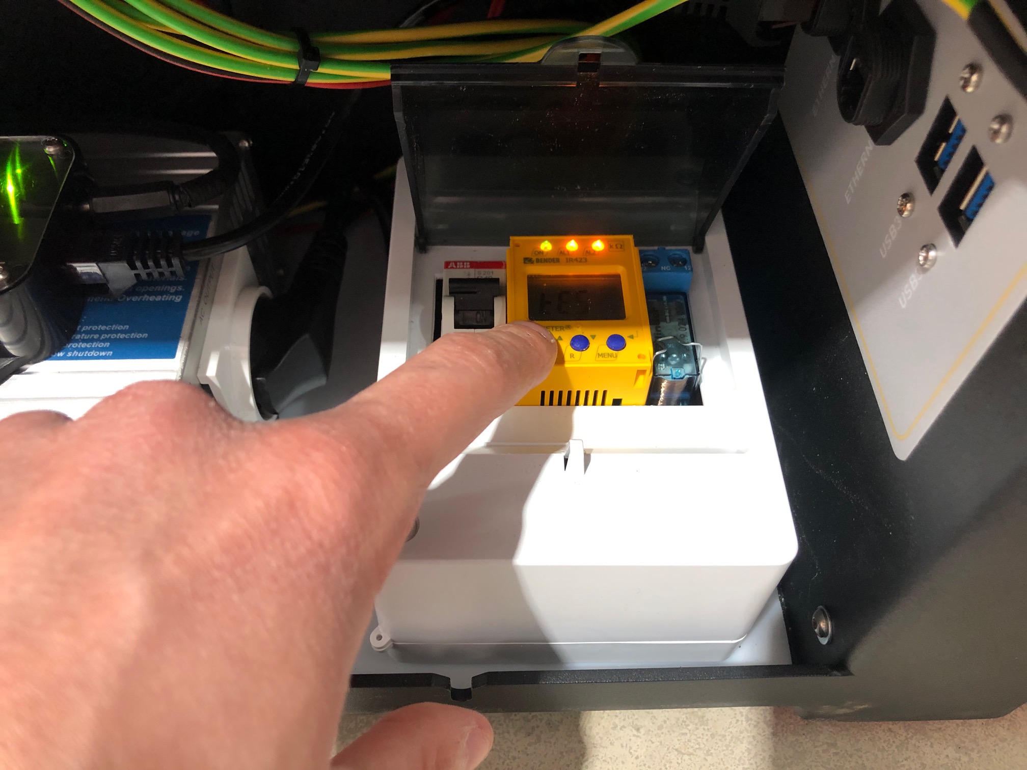

Safety feature based on the Bender Isometer
LED status of the converter on top of the Ridgeback
Power cut-off in emergency situation
Bender Isometer
Safety Check on Startup
Checking internal resistance
Pushing Test-Button
No change in resistace was recognized
Power will be supplied
More information on the Bender Isometer.

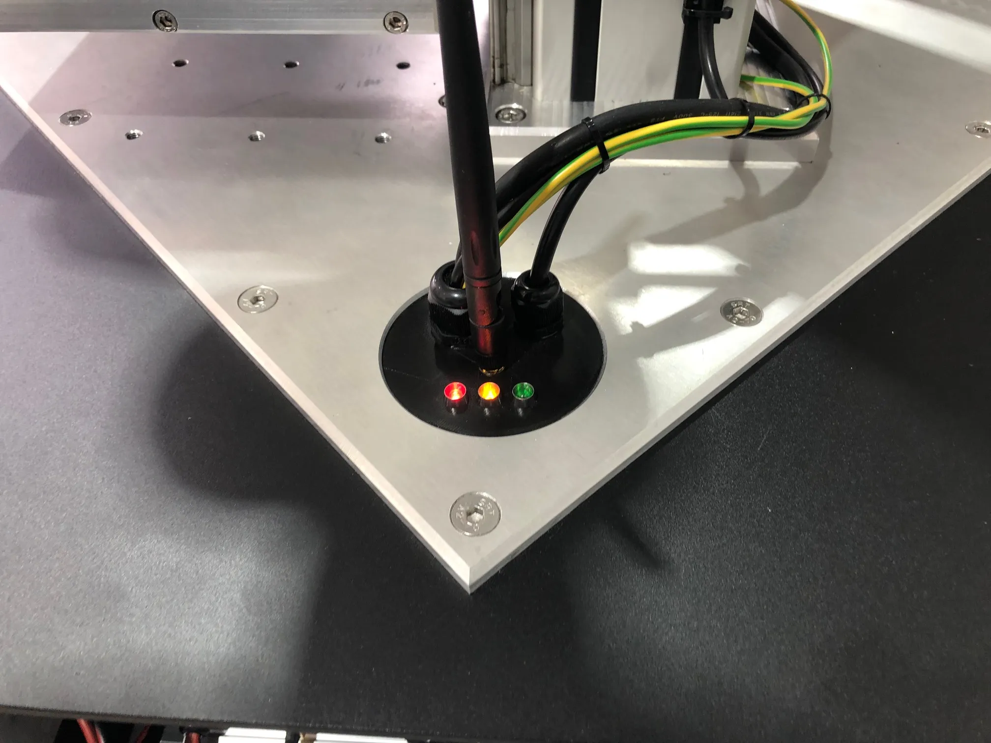

LED Indicator
Green: 24V DC was supplied to Converter
Yellow: A failure has happened, operator must stop working with the robot, and must check for a broken cable etc.
Red: Power was cut off

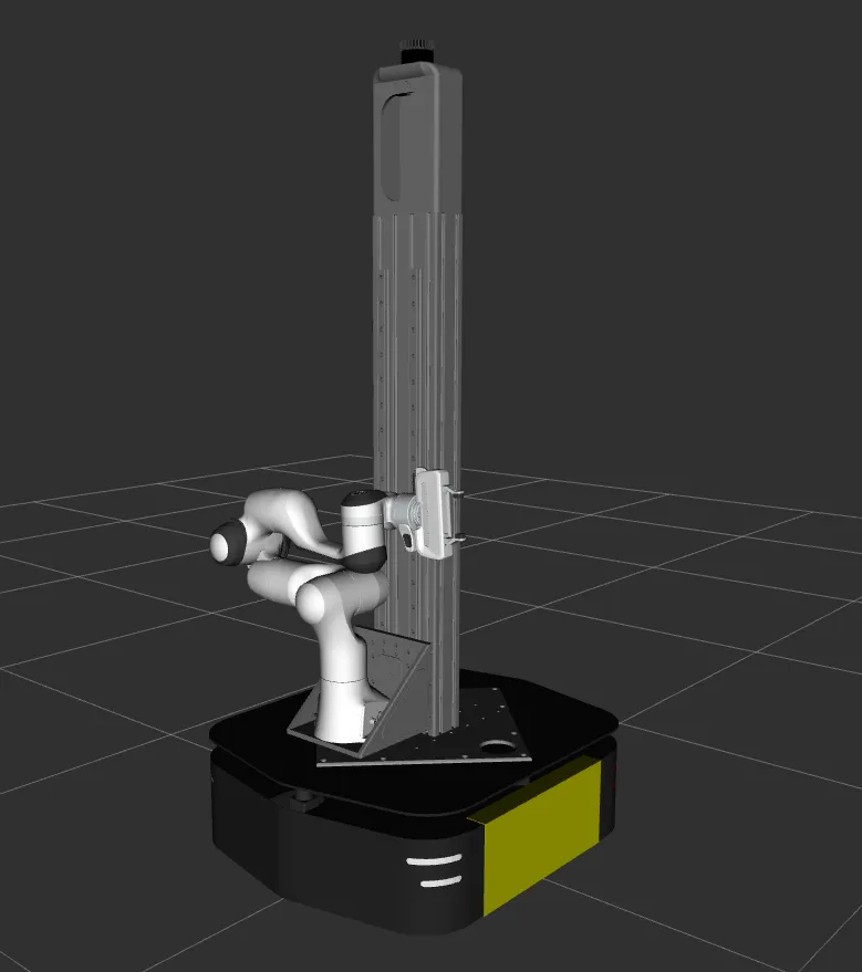

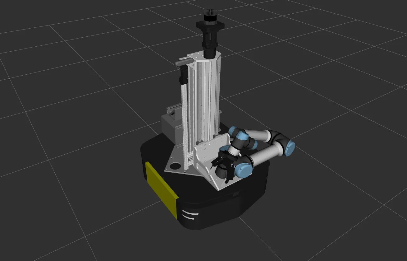

To view the URDF model of the robot:
roslaunch rp_viz view_model.launch
Ridgeback UR5E Rviz

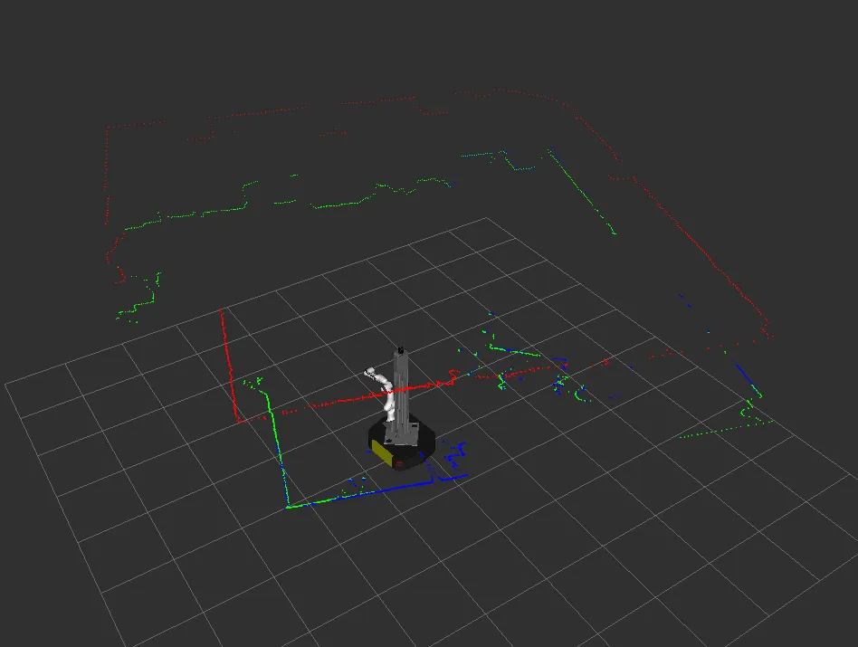

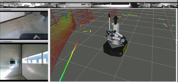

To view the live sensor data from the robot:
roslaunch rp_viz view_robot.launch
Rviz with Ridgeback’s whole body control demo

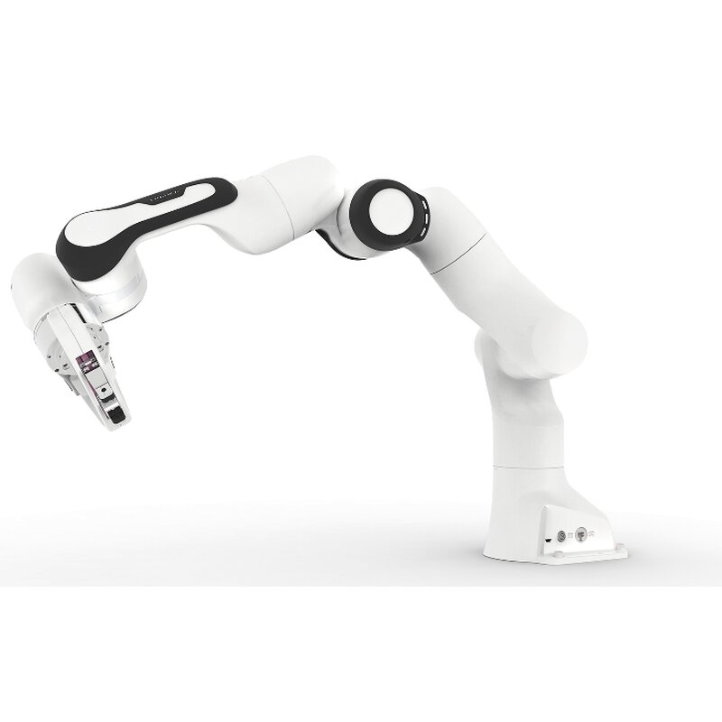

Franka-Emika-Panda
As the MYBOTSHOP Ridgeback Panda is a multi-robot system consisting of Franka Emika’s Panda, hence, the guide provided by Franka Emika for Franka Emika Guide is applicable.
MBS Panda
This mbs_rp_franka
package is responsible for to launch Franka control software from franka control
package. Before using the arm it needs to switched on by the rosrun rp_lift sensors
To switch on the arm:
rosservice call /set_arm_power 'data: True'
The arm is switched on indicated by solid yellow lights on the robot.
To switch off the arm:
rosservice call /set_arm_power 'data: False'

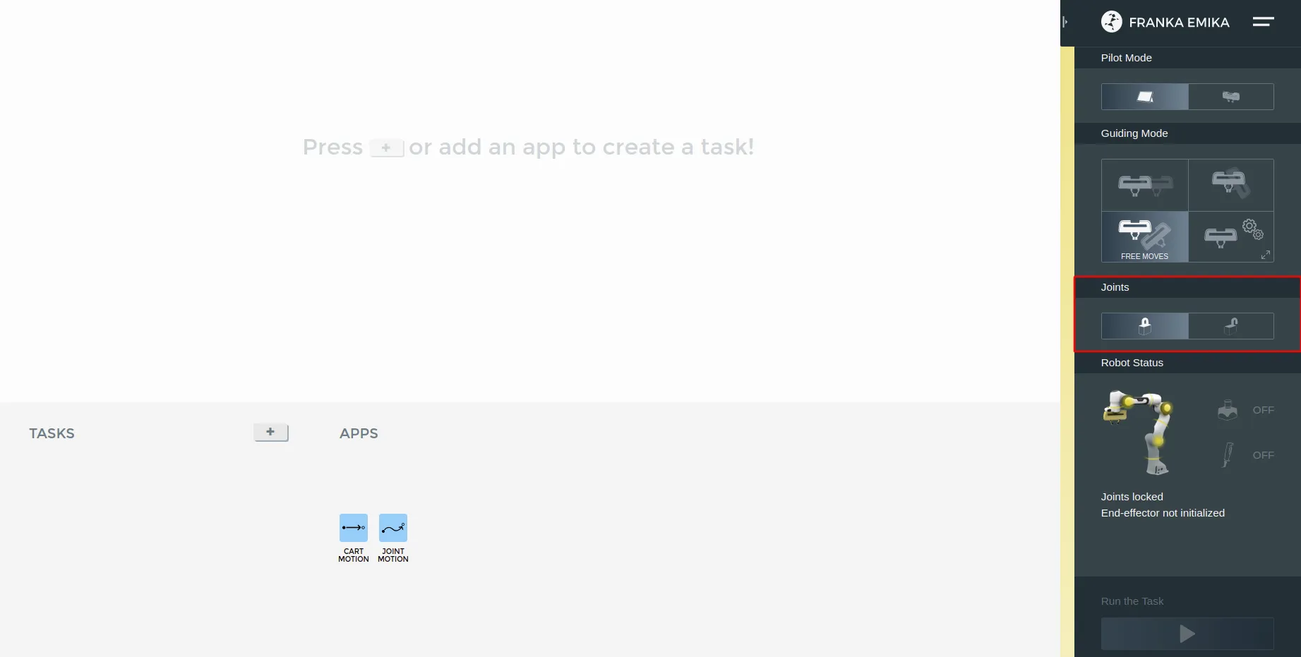

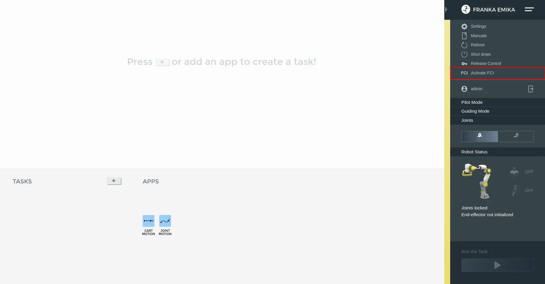

Panda Setup
Once arm is powered on, one can access the Panda desk at 192.168.131.22
The desk will prompt for user name and password which is:
User: admin
Password: panda_admin
Tip
Getting started with Panda Desk
First the arm joints should be unlocked as shown.
After the arm’s joints are unlocked, FCI needs to be enabled so that the arm exposes its functionalities to ROS control i.e. to be externally controlled.
Finally, the push button connected to X2 port of the robot needs to be pressed as well.

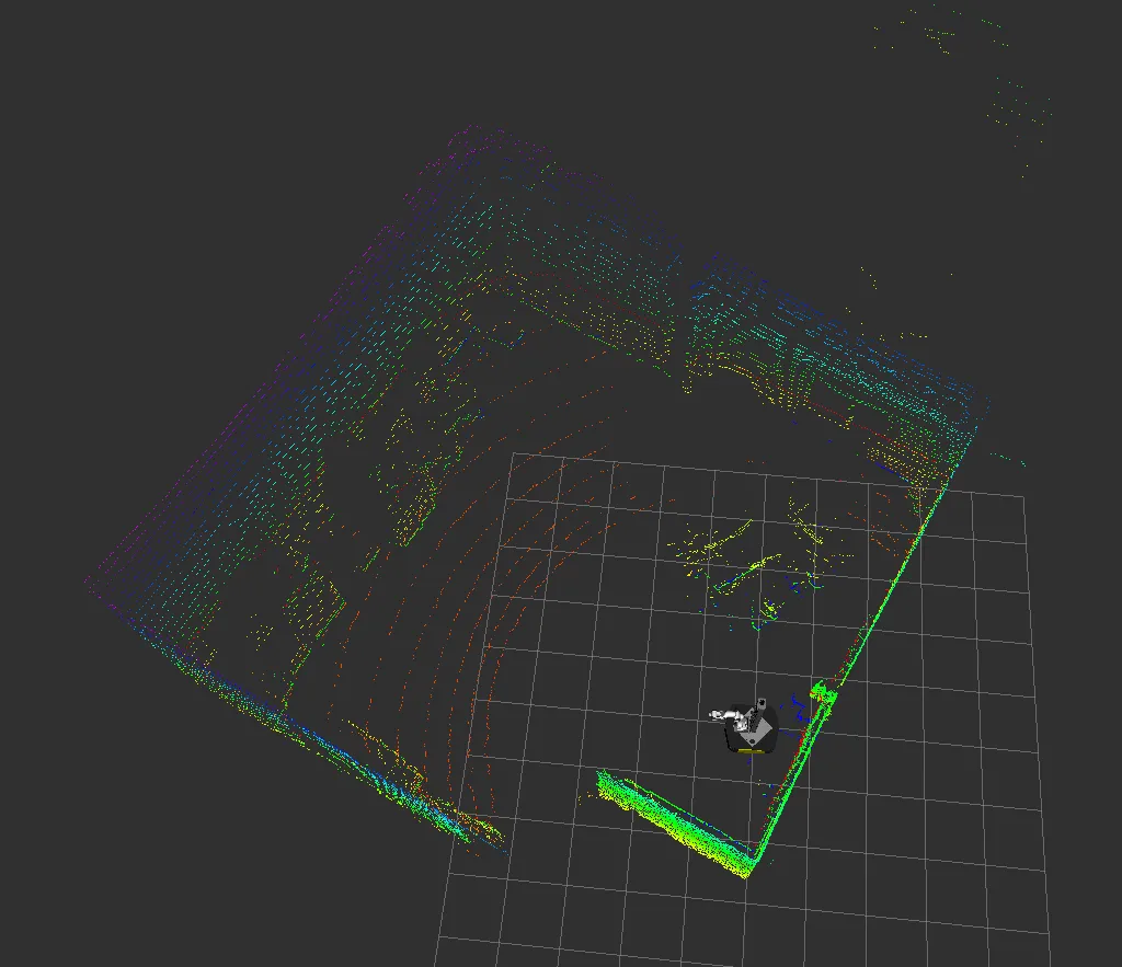

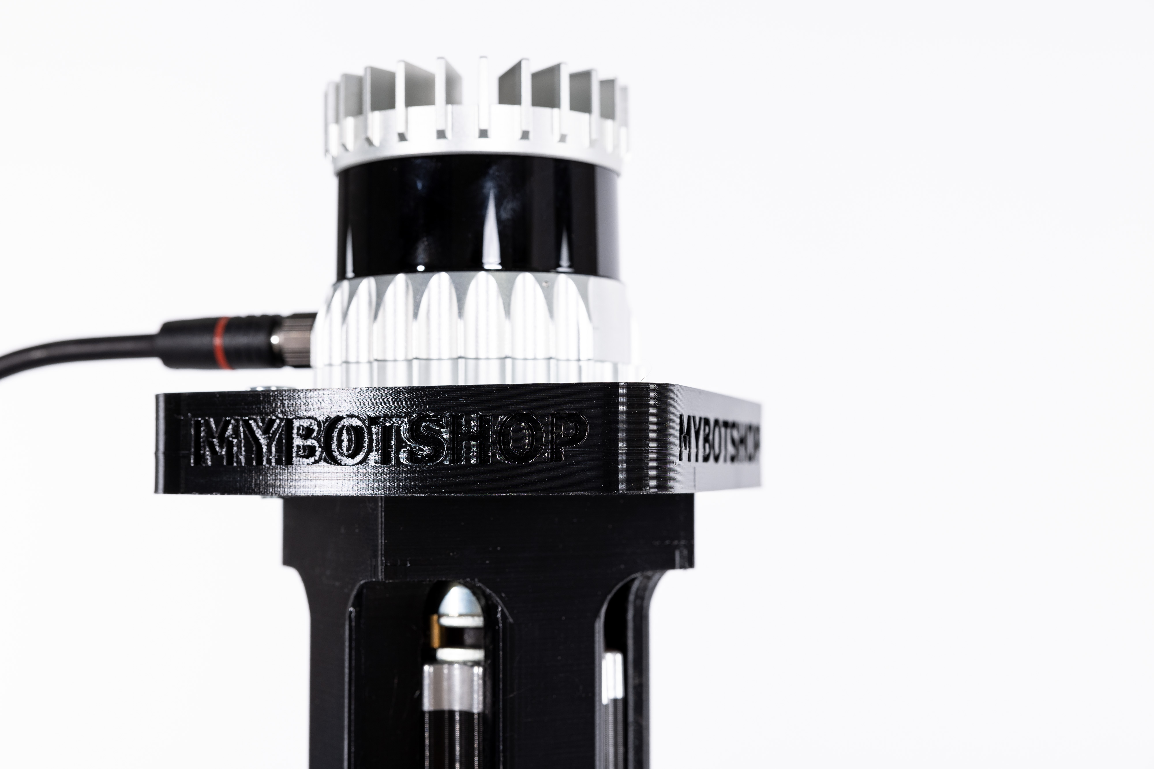

MBS Ouster Package
The mbs_rp_ouster
package cleanly manage the nodes/data/logs of the ouster sensor.
Ouster is mounted on the top and provides 3d pointcloud of surroundings. So this packages
provides two types of data:
3D pointcould: is provided on /points
topic.
2D pointcloud: is the down-sampled data of the pointcloud topic and is
provided on /top/scan`
topic.
