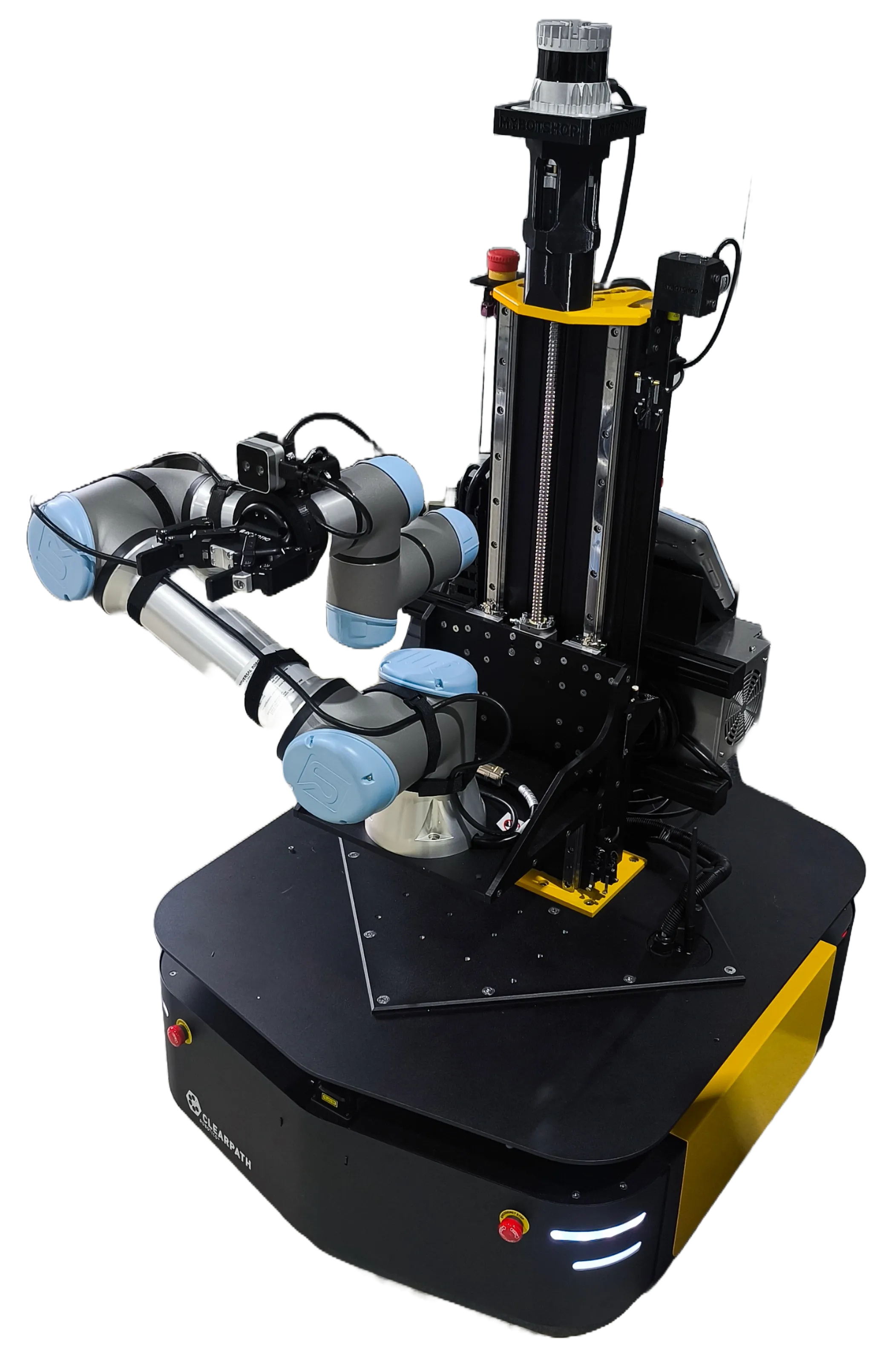

MMP BI
This specifies the configuration for Mobile Manipulation Platform (MMP) BI version. It has the following components Custom Lift System ,Stepper Motor, Rope Encoder, Ouster lidar, Intel realsense D455 and D405 depth cameras, Universal Robot UR5e and Robotiq 2F-140 gripper.
